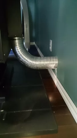

Alright. O.A.K. is installed, fans are off, stove is fueled and ready to roar. I did however, forget to purchase a wall plate for the inside wall. Ooops, sure the wife won't like the looks of that. Now, to just sit back and see if it makes any difference.
Only time will tell now, but, as I have to head out to work soon, I won't know until I get home at around 1:30am. With the temps getting to -25::C (-13::F), I hope that it works.

Tell ya what, that is a nice job!
You cut it in nice and tight, might not even need a wall plate back there.
You did put a screen outside to keep the critters out right?
Fine job!
Thanks Hogwildz. Wife said I don't need a wall plate on the inside either. Looks good just like that.
Yes, there is a screen on the outside to keep critters out, but, for now, it is just out the wall into the garage. Not to worry though, there are no vehicles parked in the garage.
