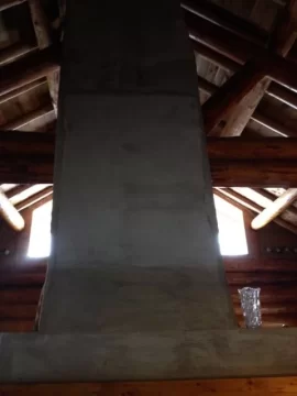

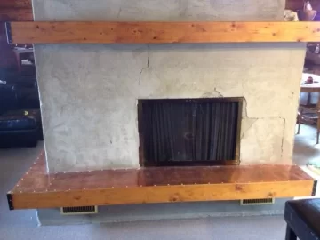

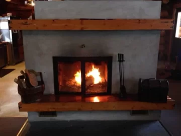

You can see how inconsistent the surface is right now and that it is crumbling off in areas.

Here are some pics of my central fireplace as it is, crumbling cracks, crevices and eventually to-be-replaced insert.

No need for redundant posts, just bump the thread. I'm confused by the posts. Is the shot with the fire burning before or after the one with no fire? Has there already been some stucco repair done?
I'm also concerned about that hearth. How is it constructed under that copper sheathing? Is there wood underneath? Hopefully not.
I think it was originally a see-through fireplace before the back was closed off rather amateurish. It looks to me like a prefab; I would suggest getting a licensed chimney sweep in to see how safe it would be to put an insert in there. Since the hearth is certainly not up to code I doubt someone knowledgeable built that thing. There may be more dangers lurking in the whole construction than what we can see from here. And if the underground is chipping away, putting a new finish on top of that won't help.

The images show the front and back of the fireplace. It was originally a double sided fireplace that has glass doors on one side and mesh curtains (? don't know what they are called) on the other. It appears to be black or unlit on the one side because the original insert came with an optional metal panel that could turn it in to a single sided fireplace. The panel was put in place but never actually bricked in.
The copper covers brick and mortar right next to the fireplace, but the front edge is a decorative wood trim witch is completely covered on the top side by the copper plate. Even though this setup passed both a home inspection and fireplace inspection, I have never been a fan of having the wood there but it will stay and be used like that until we can get to the fireplace renovation (which is happening right after I am done painting my kitchen cupboards this weekend). I'm looking in to other equitable options for the hearth while I am researching the resurfacing products.
My concern seeing the images is that the non-burning side shows serious delaminating of the stucco. This makes me concerned that the original job was not well done. If so, putting a surface coat will not stop problems with the original coat showing up

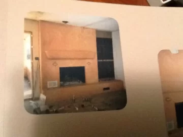

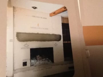

I once remodeled a house for an aunt of mine that had a very dated brick fireplace built in the '60s. She wanted the house redone with a "southwest" look. I covered the brick with concrete board and then covered that surface with a product called Quikwall, made by Quikcrete. It is meant to be used over cinderblocks that have been stacked with no mortar. It's a fiberglass reinforced concrete. I tinted it to sort of look like adobe. Sorry I couldn't scan these pictures so I took pictures of pictures.

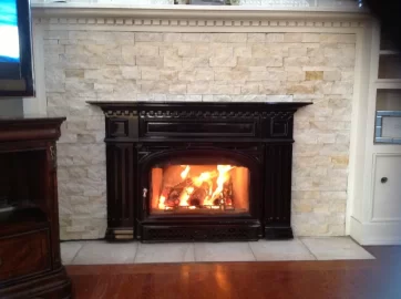

Our fireplace looked like Hiites, we easily refaced it with these sheets of stones, they are 1/2 to 3/4 inch thick, and made a world of difference. Cost for this space was $180. You have considerable more space to cover. Good luck......

Thanks so much for the input. :) Love the pictures. The stone sheets are great, would be a good option for the bottom and have a colour coordinating paint or stucco for the top once I crack fill and make it an even texture, or use the concrete sheets on but I would have to research to see if this is available here.
