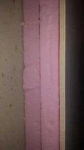

I know that this doesn't answer your questions, but I'm in the basement looking at temperatures and thought I'd take a picture of the cross section of my basement walls. Again, not what you're looking at, but you could take a run at that wall and bounce off.
So, party at your house? :)
I don't think too many will doubt that is the best way to do it, but what is that 2 sheets of 2" XPS? Each board is $25 per 4x8 and you have two of them. That makes $50 per 4' of wall...without labor, without framing...ect. Nice,,but pretty pricey.
I purposely didn't add up the cost...just went to HD every once in a while a bought some pieces, lol.
For me, there was no framing, just furring strips. And, the original poster is going to get someone in there to foam the wall, so that's not cheap either. Maybe only use one layer?
