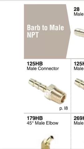

I used shark bites on my OPB (pellet boiler by CB) They did just fine for 4 years, and the guy I sold it to is still using some of the same fittings. I had them out on the inlet and supply on the boiler, as well as inside on the HX.
I ran 180* water.
I used the badger fittings. Or ones found on ebay. Then put two hose clamps on each one ( bulk on ebay), they have held for 10 years no problem. Then you don't have to buy crimp tool.
