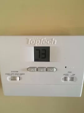

I installed a Central Boiler 6048 last fall. I had to install a generic thermostat to control the boiler. I wired the new thermostat to the old thermostat that controls an electic heat pump with an electic furnace for back up. I want just one thermostat instead of the two I currently have. Is there such a thermostat that can control the heat pump, electric furnace, and the boiler?
