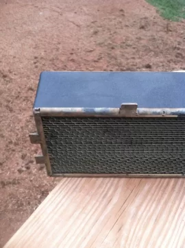

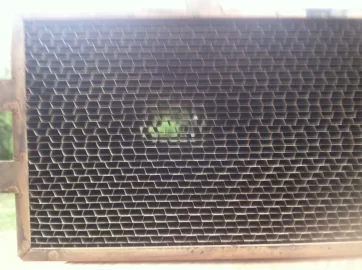

image.jpg image.jpg image.jpg I received my steel cat from condar today and it is durafoil. There's something wrapped around the outside of the can. It appears to be tape, I'm not sure why it's there. It goes around the whole perimeter of the can. I still have my ceramic cat installed so I'm not sure of the fit. Maybe the gasket is between the durafoil and the can and the can will expand outwards? I guess there's only one way to tell and that's to install and fire it up!

View attachment 184517 View attachment 184518 View attachment 184517 I received my steel cat from condar today and it is durafoil. There's something wrapped around the outside of the can. It appears to be tape, I'm not sure why it's there. It goes around the whole perimeter of the can. I still have my ceramic cat installed so I'm not sure of the fit. Maybe the gasket is between the durafoil and the can and the can will expand outwards? I guess there's only one way to tell and that's to install and fire it up!

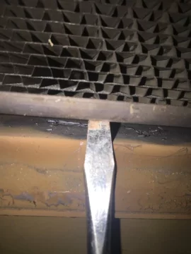

Fired up the stove last night. It wasn't quite stove weather but I really wanted to see if this new, no gasket required Steelcat had some kind of magical expanding properties.
It doesn't! If anything it feels and looks like a looser fit than before I lit it off.
I did contact Condar via E-mail before I tried it concerning the 1/4" gap and asked about a gasket. I got a quick reply that stated no gasket is required and to remember air would take the path of least resistance. Ok, I would think a 1/4"x10 1/2" opening above the cat would offer very little resistance But what do I know lol

I used the tip of the screwdriver to push the cat up. It was easier to show the gap from the bottom than trying to get a pic from the top of the cat. Besides the tip of screwdriver makes a good reference.
I doubt I will pursue this any further with Condar. It's pretty clear that they believe no gasket is needed and I believe it is.
See, once again, buying direct from BK would have prevented this issue. The third party has no idea what they are doing. They have "doubled down" on their decision that no gasket is needed which is in obvious and direct conflict with the manufacturer and even the law. You are bypassing an emissions device without that gasket.
