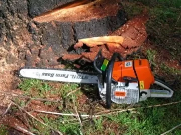

    Put an 8 pin rim on the 460 with the 18 inch bar with a full chisel chain, round filed, and go to town. It will rip through anything, except crud and grit, in which case run it with semi-chisel chain.
    Here is my (then) 460 with a 20 inch bar on it. I dropped this 30 inch DBH doug fir like it was not there. That is the factory 20 inch 'Farm Boss' 3/8 std Stihl bar from a 290 I had. Note the multi-chunk wedge I took out of it... I am more used to dropping those size trees with longer bars and not having to cut from both sides. For me shorter bars means longer cutting time. A 28 or 32 bar fits that saw a lot better.
