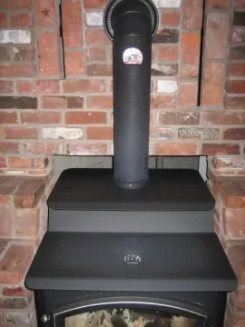

    That second thermometer will help a great deal. I prefer to place the gauge on the top, about 6" back from the front edge. Here it is in direct contact with the firebox and not over the insulation. Next time you have your door open and cool you can look at the top of the firebox where your gauge is getting its' reading from. I like 500 degrees or more on this gauge (to activate the secondary burn) and 250-350 on the gauge on the stovepipe (about 24 inches above stovetop). Don't give up on those 10-12 burns yet. I see them with a packed full firebox. You are still getting used to the stove and your wood will get better. My splits are about 18" long and of course loaded N/S. When it is really cold I also load shorter splits E/W in the space between the N/S splits and the door.
    Try to edit and add a pic of what I was talking of therm placement on the Quad:

    The temp of 450* on the face would probably translate to 600* on the stovetop with three 4" splits. I only wanted a small fire since it was relatively mild, about 30 degrees outside. The stove is in the basement, 1000 sqft. recently finished and insulated, but heats the remaining 2000 sqft new construction colonial. Last year the quad kept up relatively well except for the coldest nights but the basement was unfinished and I was burning cherry. I've only been burning for two weeks this year but the finished basement and insulation as well as the two year seasoned oak have kept the basement at 85 to 90 degrees without overworking the Quad. The first floor is about 75 degrees and 65 in the second floor bedrooms.
