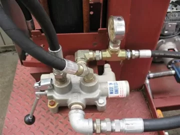

    Place the gauge between the pump and control valve. This position will give readings for all functions, extend,retract,and bypass. With gauge close to valve it is usually easy to read and generally protected.

    thx for pic of gauge that will help lots- just ran out and checked outside of cylinder is 4.5" ram is 2.25". so far only ran it about 1/2 throttle and has split everything i put in it.just wanted to put a gauge on it and maybe a table so i don't have to keep picking up pcs to resplit

    Very true, but unless you were trying to troubleshoot a problem, why would you be interested in the relatively low pressures of bypass and retract?

    With gauge before the valve you can check for any binding when retracting. You can also set the bypass and detent pressures of the pump, valve and detent. Why put the gauge where you can only check one thing .

    "Detent Pressure" - yeah that would make sense if you had a need to alter it.
    I don't install mine there because with my config the gauge would be where alot of the "action" is with my hands, but I can see where it could be handy there.

    Yeah, I am thinking that rebuilding the push plate may be time well spent.
    By looking at the placement for everything, I believe triptesters gauge position makes the most sense.
