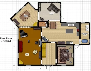

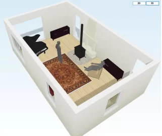

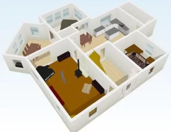

I am doing my research and planning for a woodstove. I am trying to simulate how the stove might look and work. So I mocked up a 3D rendering below showing the first floor of my house with the woodstove installed using an existing fireplace in the living room.

a. The size of my house. The first floor of the house is ~1680sf. The 2nd floor adds another ~1400sf in 5 bedrooms. For a total of ~3100sf. The insulation in the house is typical 1940’s construction. We do most of our “living” on the first floor. So I want a stove that will at least handle heating the first floor. If any “extra” heat wafted upstairs to supplement the separately-zoned oil heat in the bedrooms, great, but I don’t realistically expect to heat all 3100sf of my house with a single woodstove. That being said, I do expect the woodstove to “take the edge off” my oil bill.
