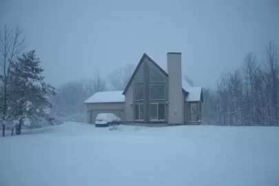

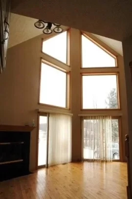

    I've just about decided to get the Quad 4300 ACT but a little concerned about sizing? I have a 1500 square foot with over half an open floorplan with 32 foot ceilings A-Frame Style. Main room is 28' wide and has 12' side walls with ceiling fans. Dealer wants 1750 for stove complete + install. Other options are Lopi Ranier or Leyden. What do you guys think? about enough stove for the place? I plan on ordering 3 cords of Hardwood to get started plus harvesting off my land and becoming a big srounger for wood. Sound doable but install on this roof is costing loads. Needs bucket truck to get to the top. Plan on taking out Gas stove and putting on that wall if possible. Installer coming to evaluate in the morning. Need advice by then.

    Wow! Look at all that glass! Where's all the furniture?
    I don't think the 4300 is too much stove, particularly in Michigan. You WILL want a ceiling fan in the top of that room to push the heat back down, though.
    Great price on the stove, BTW. I paid $2350 two years ago with nickel trim. I'm jealous! I think you will be very happy with it. I find it's very easy to start and control a fire in these things.
    Chris

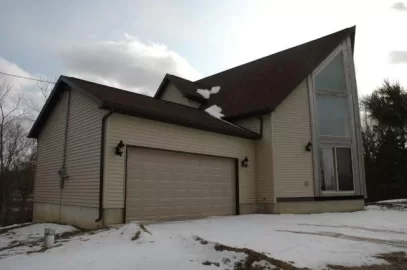

    Found these before we bought it after leaving DC area to move back home. Three year old repo house bought right, Also included shot from last winter for comparison. Thanks for all the replies everyone. When your new and spending this much you haved to get it right the first time. Again thanks to all, when the install is done I'll post lots of Pics.
