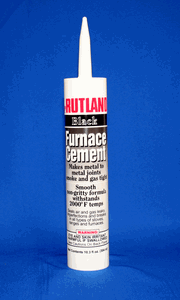

    If you ever have a chimney fire that's going to make a stinky mess and be hard to clean. I think they mis-understood you. High temp silicone is OK for double wall pipes, but not recommended for sealing single wall pipes. If you want to seal a single wall pipe use furnace cement.
    Also, you wouldn't be able to get those pipes apart for cleaning / replacement if you use silicone very easily. Furnace cement forms a good seal and will crumble and can be vac'd up when it's time for service.

    Yeah, the highest-temp caulk I've heard of is rated for 650*...they must have meant cement.

    yep yoop, furnace cement....

    Definitely do not use silicone (or RTV) on the flue pipe. For single-wall joints, uses a silica-based cement adhesive like those Rutland makes. No need for any cement the joints on the class A pipe.

    Glad you are getting it in Dave. You'll figure it out in no time flat. I'll also chime in on the furnace cement. We've used that for the 50+ years we've burned wood. It is easy to work with, easy to clean up and does what needs to be done. On top of that, it is cheap to buy too.

    found a tube of furnace cement today for $4. i was suprised cuz the place that sells it is more like a jewelry store when it comes to pricing items!
