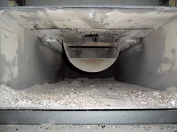

I will be inserting a high temp. thermocouple into my secondary chamber by the weekend and will let everyone know how hot I'm getting in the secondary chamber. I'm getting a lot of ash fushion (ashes are welding themselves together to create "hamburger patty" pieces in the stainless steel "half pipe flame deflector") and thus I know I'm over 2,000 F.

I haven't seen the photos of the bottom chamber. You state stainless steel deflector. This is interesting as I didn't think steel would hold up in these temps. If possible could you add a photo of this in the pic post you did for this boiler. The more I see this boiler, the more interesting it becomes.
When my ashes used to cake up like that i thought it was the type of wood i was burning? and it was burning good to produce nice fine ash.

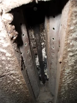

Yes, the flame deflector in the effecta 35's secondary chamber is stainless steel and is very easy to remove. In addition, the burner tube in which the oxygen for the secondary combustion is supplied is also stainless steel and contains 70 holes in it. Unlike many other gasifiers which have 4-6 holes in which to mix the oxygen with the gas (smoke) from the primary chamber, the effecta design consists of the stainless burner tube encapsulated in a 4 piece ceramic. Because of the long, stainless burner which has 70 holes in it, the mixing of the gas with the oxygen is very thorough and efficient and results in very high secondary temperatures.
Another unique feature of the effecta is that the entire secondary chamber is water jacketed boiler steel (except for the door which has a very thick heat resistant material. Thus, the extreme heat generated is able to be transferred to the water very efficiently and results in normal chimney smoke temperatures of 150-170C (I have yet to see it get over 180C at any time). Because there is a sensor to measure the chimney smoke temperatures it is easy to tell when the heat exchanger tubes need to be cleaned.
I know there will be some that will question the use of stainless steel in these areas in addition to the fully water jacketed secondary chamber, but I have researched these areas of concern very thoroughly before partnering with effecta. I spent several days with effecta in Kungsbacka Sweden last summer and was very impressed with the entire effecta staff and manufacturing operations. In addition, effecta has been manufacturing these boilers since the early 80's and has been using the Lambda sensor and stepper motor system since 2000. Thus, they have substantial experience with gasification boilers and being located in Sweden (one of the most stringent European Countries) they have been forced to come up with unique engineered solutions to make their products very efficient and long lasting.
