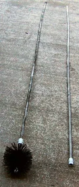

    ^yeah that's what Gooserider does too...he contributed to a thread and explained how he made it out of 3/4". I didn't realize it at the time but that conduit can almost bend over on itself so your can sweep the chimney from the basement. I was thinking about doing this myself cause mostly it's easier to get a better grip with 3/4 pipe.

    Same here. PVC pipe is much cheaper.

    are the couplers plastic or steel pipe?---looks good and cheap---thanks for the help--pat

    If you get the grey Non-Metallic-Conduit intended for electrical work, you don't need fittings between the sections, as each has a "belled" end that fits the next section. I think the grey stuff is also more flexible than the white plumbing pipe. The only fittings you will need is something to go from the male (non-belled) end of one tube to your brush. You can use the white PVC fittings from the plumbing department for that, I also had to use a schedule 40 reducer bushing to get down to the 1/4" NPT my brush is threaded for.
    To keep the sections from coming apart, drill a hole through each assembled joint just big enough for a #10 or 1/4" bolt and nut. This will allow you to take the rod apart for storage. To put the brush coupler on, use normal PVC pipe cement.
