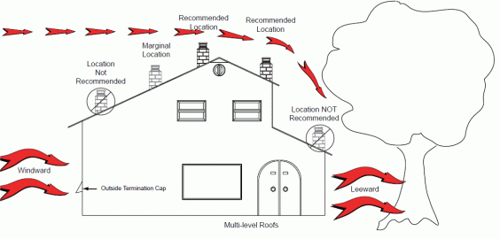

    At what point in the storm did this occur? Did snow build-up on the roof change the characteristics of your roof line enough that it cause the wind to blow down the flue? (see attached image) Did a mound of snow and heavy snow on a nearby tree cause something like the flue on the right of the image?
    The other possibility, a flue fire with a partially blocked cap, is also a good guess. Did an inspection afterwards show any signs of a flue fire?
    You mentioned your cat is shot, any other maintenance issues with the stove?
    Pictures of the roof line, the flue, and the cap will help sort things out.

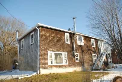

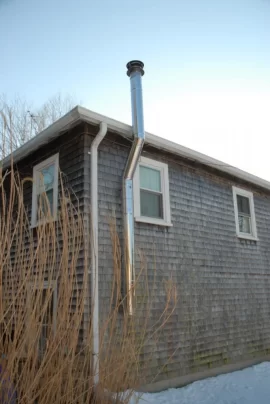

    I'll try to answer all the questions in one shot! The house is an old summer beach cottage, built in the 30's. it's obviously been through a ton of changes, It was dragged to it's present location and jacked up for a garage some time in the 50's. In the mid 70's they added the back half of the house (wood stove is on the ground floor of this part), Central Heat, and insulation added (R-13/ 2x4 walls). In the 90's they added Vinyl Windows, re-sided and wrapped the house, then added R-48 to the attic. We took it over 2 years ago, and did tons of sealing (took every window out and insulated around them), caulking and replaced every door (except 1 storm door). So yes, it's a pretty tight house!
    Hah, issues with this stove? Worst one i've ever had. It works the way it's supposed to, but there's way too many parts to go bad, and it's way too complicated to work on.. As stated above it's 6" Duravent Class A Stainless, about 18' vertical exterior. Inside, from the flue collar is 3' to a 90deg, then 2ft of horizontal through the wall "thimble", then outside to the "T", cleanout on the bottom. No evidence of blockage or a chimney fire, and it's actually a lot cleaner than i thought it would be since i checked it a month ago. Less than a 1/4" of fly ash built up.
    Hopefully you guys can see from the pics what my concern is. This exits on an exterior wall, is 3ft over the roof height of this section of the house, and the total height difference between the chimney and the exhaust fans, and furnace is almost 8ft. I've watched the way the chimney works against the wind, and it always seems that it comes over the higher roof, and works its way down. MR2_2555.JPG MR2_2557.JPG MR2_2559.JPG MR2_2561.JPG

    KaptJaq, I just saw this, YES, this is EXACTLY what I was trying to get at. And YES, the side if the house with the Chimney is always on the leward side. We live on the water, and the wind is almost always out of the south, Chimney is on the North Side of the house.

    Is there any possibility of moving the flue & stove over to the windward side? If not, maybe a different cap would help.
  20. Matt Ruggeri New Member
    joined: Nov 23, 2012
    23 posts
    Rhode Island
    It's good thought. I think a different cap would help. Moving the stove would probably be impossible, as we don't own this property yet (hoping to buy in a fwew years), we rent/manage it for my wife's father. 6 different installers passed on this install, all because of 3 reasons - It was a corner install, the owners didn't want the roof cut, and they would've had to custom build those extra heat shields for the back/side walls around the hearth, as requested by the local inspector (and in the install guide). All of them said it was too much work. Most guys around here want to do the least amount of work for the most they can charge!

    Another possibility would be to add a section of pipe to the top to raise it above the turbulent airflow. If you do this make sure you add pipe braces as necessary. I would also consider adding a MPD (manual pipe damper). The extended pipe will increase the draft on normal days and the MPD will enable you to control it better.
