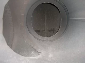

I have attached a picture of the inside of the chimney after burning 2 cords of wood .
