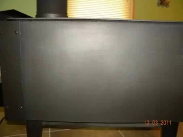

Last night my Vogelzang Durango ( China I have found out ) almost burned down our house. We went to bed and it was coals at 400 degrees no wood load in the stove at all ! The wind picked up and was howling absurdly load then I smelled smoke a recure of paint I think. Thank the angels I woke up an RAN down stairs shut the air down and prayed for it to go out without a fire. The stove was cherry red and of course now the sides have ridges in them and you can feel them sticking out. Has this ever happened to anybody else? I can only guess that it was the wind pressure making it so hot, it took 1.5 hours to die out enough for me to feel safe. This has never happened in 5 years of wood burning to us!
I have pictures of the buckled sides for you guys to see, its amazing too look at . The ridges are toward the top and the top looks warped up a little. Would this be safe to use still or is it shot?
Thanks again Guys

Pete, that doesn't sound right. If there were only coals in the stove, how did it get that hot? Perhaps it was half or more full of coals? Also, I've never had an issue with wind sending our stove into a hot spell. Usually there is little to no effect from wind with our stove.
Would it be safe to continue to use the stove? It would scare the whatnot out of me after what you've described and if it is warped, it could really cause some big time problems that you do not want to deal with.
wow....that a nightmare. the man upstairs obviously aint done with you yet. if i burned it, it would be starting out with a small fire and see if any thing seems out of the ordinary. another thing you could do is check for a light leak at night with the lights off using a flashlight inside. that might help with questions about the integrety of the stove. another thing i do to help shut down stoves and give me more control is add a damper to the pipe above the stove. in most cases, especially with more modern stoves it isn't necessary but I'm a bit anal about it. we always had one growing up....and i've used it a couple of times to help shut a stove down faster when i've forgotten to close it down once going. good luck....and throw an extra $20.00 in the offering plate tomorrow........and check your smoke alarm batteries.

Yeah venturi effect from the wind blowing across the top of the pipe can do it if the cap doesn't have a wind guard. If it was chock full of coals then it essentially turned into a forge. With a 3/16" plate stove body and top plate after the glowing starts warping ain't gonna be far behind. There is nothing inherently dangerous about burning in a warped stove. The big question is what kind of stress the welds are now under. And that could be dangerous.

Edit: And are the ridges where the brick retainers are welded inside the stove?

There really wouldn't have to be with a quarter of that long box full of coals. Them suckers would have been white hot in a heartbeat with the primary air that suction was pulling right into them. Same thing happened to me last year. That is what caused the 30 to take off for the moon. I had just loaded it for the night burn when the wind took off all of a sudden to fifty miles an hour. That open cap of mine let the wind fly right over the top of the liner and it became a 21 foot drinking straw. Fortunately I have the unregulated air blocked off and so secondary air was the only source so the stove only went to thousand degrees stove top. With the quarter inch plate with a step bend in it on top of the 30, no warping.
The Durango is 3/16" on top with no reinforcing bend. VZ is the only make I know of that does that. Everybody else does 1/4" with the step bend or 5/16" with the flat tops. 3/8" on the PE big boy.
