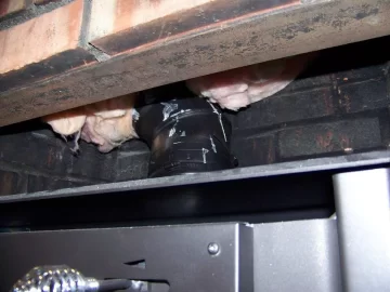

    About a month ago I had a insert installed. 6" Flex SS liner wrapped w 1/2" insulation. Did the 3 burn in fires and used the excuse of the low target temps as the reason my flue temp wasn't getting as high as recommended. The last fire called for 450 insert top and then I was finally able to get the flue up to 300 but only when the door was cracked up or the draft was full open. I was using a Harbor Freight IR gun to measure it and while I did haven't a reason to not believe it I went ahead and ordered a Condar stovepipe thermometer. Since I am not using a surround I can look/aim above the insert can get temps off the pipe but once that insert gets hot its really tricky reaching around it and figured one day it was going to bite me so best just get a magnetic one. Anyhow went to put it on today and for the life of me it won't stick anywhere on the connector pipe or just above it. The pipe is cold at this point Is it normal or unusual for the pipe to not be made of steel?
    So on the 4th firing of it today using pallet wood and a top down fire its going really good about 5 minutes in and the air control on full open and the door is open 1". The temp by IR (since my Condar won't stick) is about 120F as high up as I can aim before its insulated. Its 90F just above the insert itself. Being cautious I felt the pipe and sure enough its warm, but that's it. Seem to me it would be hard to have a hearty fire started in the stove and the flue pipe only be warm to the touch given the comments by others about how fast their flue's heat up. The temp of the stove top (the inner box of the insert's design) is 200+ F at this point. Is the connector double walled and I just don't know it or is there some other reason I can't get the flue very hot? For another data point 2.5 hours into the same burn the inner box temp is 300F and the pipe temp is 150 F

    The liner should be stainless steel, which is why the magnetic thermo won't stick to it. Looks like in your pic, there is an adjustable elbow from the liner to the stove connector opening. And looks like everything has been painted black. Keep an eye on that elbow if it is indeed an adjustable. They have a tendency to come apart, especially while running a brush down it while cleaning.
    How tall is the liner? Sounds like either not so dry wood &/or poor draft due to short liner.

    That also looks like standard pink fiberglass house insulation stuffed up above the insert.

    1) 30' worth of liner. 2, 45° elbows. Chimney is inside for the first 15' and outside for the last 15'.
    2) Haven't had issues starting a draft. Only time I problem with smoke in the house was the first couple fires when I was jerking open the door and not using enough kindling
    3) I hadn't measured the pallet wood I used last night, but the pallets have been measuring ~15%. They start right up now that I'm given them plenty of air around the sides and using a top down fire, no issues with smoldering now.
    4) Everything was painted black by the installer, a CSIA chimney sweep, as you'd see the liner from inside the room since I'm not using a surround
    5) Hadn't though about the fact that this grade of SS wouldn't be magnetic. I should have thought of that.
    6) That insulation does look like the standard type. The sweep is the one who put it there. I guess I should take it down and replace it with roxul. Does the roxul have to the insulating type or would the sound deadening type work? I already have the sound deadening type from some sound proofing I did. Its just meant to be a physical barrier to air flow right?
    7) After the first load went to coals last night I loaded 2 splits of beech on top, they caught fire well within a minute and within 5 min were fully aflame, again no visible smoldering. I dialed the air back to half and 30 minutes later the stove is reading 420 F (inner box as I have the blower on at this point) and the flue 220 F. I had air fully off at that point and there was nothing lazy about the flame and the secondaries were all fully engaged.
    All I can figure is I'm rushing it and cutting the air back too soon even though it isn't smoldering. Sounds like I need to get a soot eater and do a physical inspection before long.

    30 foot flue points to a strong draw. Hearth member Oldspark last year had an issue with his stove not heating up like he wanted. He even put in a new insulated flue and still the issue.
    What worked for him was he installed a manual flue damper and closing it a 1/4 turn is all it took to cut the draft some and his stove temps came up. too strong of draft with these stoves that you

    2 elbows? why 2?, Can't see that affecting draft that much though. 30' is more than enough and the thing should draft very well. My opinion, get rid of the fiberglass, and install a block off plate in there. you can put the Roxul on top of the plate. Not sure on the sound deadening type, I would say if it has same heat/fire rating, should be fine. I would not even be cutting the air down until at least 400 degrees. I think you may be shutting her down way too soon. You will need to experiment at different settings, different temps, and will need to get used to and known the stove unless you already had a it a few years. Seems like several factors, being new to the stove as one of them. Everyone goes through it. Be patient, and never hesitate to ask questions.

    The vertical portion of the chimney/flue is behind and to the left of the fireplace so an elbow aiming up and to the left and then probably about 3-4 feet later a second elbow to bring it back to vertical.

    That is going to be a biach to clean. Might have to do the area with the 2 elbows from below with thinner rod like those used for pellet flue brushes.

    Just got off the phone with the installer and he said that what was up there was ceramic wool. While I don't have a reason not to believe him I may swap it out for my own peace of mind. From Roxul's website "Roxul Safe'n'Sound is fire-resistant"
    Thanks for all the help.
