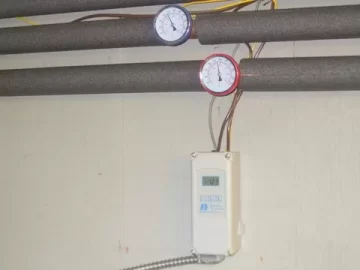

i set my father inlaws up with this. you can do draft and dump all in one with one sensor. also you can adjust temps up to 220 with a 30 degree differential.not that you could run that high.
I had to go back to the house last night to get my glasses to. No matter how far back I stood I couldn't read the #. I have my stat set at 177-180. The new stat has a non-adjustable diff of 5*. I wasn't happy when it came like that but it seems to work really well. I don't get the high spikes when the damper shuts. More even and I rarely put in more that 3 rounds.

2Beans who make that set up in your pic? Or what are the parts needed to put one together. Very interested,looks like it gives a read out of temps also? Thanks
