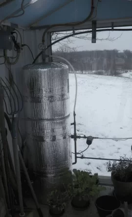

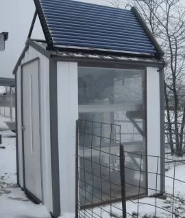

    My attempt at a solar greenhouse. It's a small shed originally built to house an EKO 40. Well insulated with 3" foam and two sliding glass doors. I have one array of evac tubes, plain water drainback. A basic 80 gallon well tank with bubble wrap. I did add a 100W light bulb that kicks on at 40F if the solar is not loaded.
    The planter beds have radiant transfer plates with pex to warm them. We have had lettuce all winter, I'm actually looking for some over-heat window operators as it does get to warm on sunny days.
    I think the key is to warm the planter beds and do a heat load to maintain 50f or whatever temperature you require. Of course the load is always dictated by the building insulation, glass, etc.

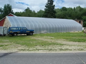

    I don't know how much it would take to heat a small one, but we heat the one in the picture. Of course it helps that there is a large radiator in it. ;-)

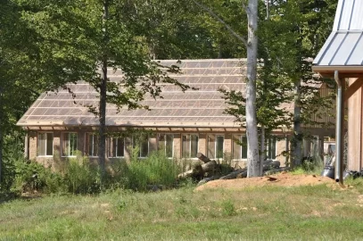

    I have fiddled with a workshop greenhouse that my Profab 200 is in. Its not insulated yet, but i find it is consitantly ten degrees warmer in the building than outside. IM excited to get it insulated and more airtight and at a minimum i think i will be able to start plants in it in March. I suspect getting the space to be 20-30 degrees warmer than outside will be fairly easy once its insulated with no supplemental heat. Maybe sooner if i protect the plants inside the greenhouse with another "cold frame". the building is in my avatar. the long sloping roof has a green shaded fiberglass product in the roof. For the "glass" Im using a fiberglass glazing that matches my steel roof profile..and my plan is to add another laye of plexiglass on the inside to creat a crude insulated window.
    I sharpen my saw in this space and the ten degree difference is huge...soon to be full on man cave.
    some cool ideas on this thread!
    barkeater

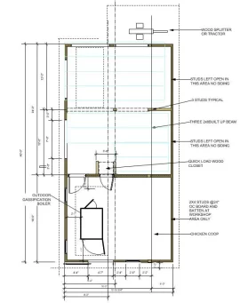

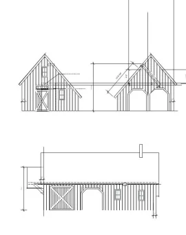

    Folks on this list have seen this a number of times...sorry for the that...this drawing shows a floor plan...

    oops, the other drawings were elevations...this is the plan.
    it was all built with rough cut lumber WIndows were made by carpenter friend for very reasonable...they are a simplifed verson of a real window..but have plexiglass. I sketched it to look a bit like a real double hung but it aint. Carpenter buddy says its basically a cabinet door with plexiglass in it. I will add a piece of plexiglass to the interior to get that thermopane action.
    cost was 13,000-15,000 including some labor help. rough cut lumber saved us thousands and it is behaving very well as it is drying out. Foundation is a pressure treated built up beam on top of crushed stone. no frost heave noticed yet..
