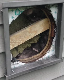

    Hello
    This hole was from a pellet stove straight thru the wall venting installation.
    What is the best way to remove this eye sore?
    I put some nice fire proof, and water proof Roxul insulation in and then a thin piece of plywood that I cut, on the inside wall and the outside wall.

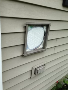

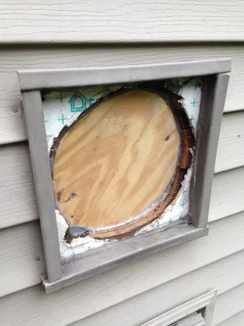

    Yes, I already cut a round piece of some plywood and screwed it in. Very solid. then sealed the edge with silicone. There is extra siding in the garage, but it would be nice to add some hard foam to match what is around it. There is vinyl siding with rigid foam under it and on top of some wood clapboards. I do not need to duplicate the clapboards just use a thicker piece of foam to bring it out to put the matching vinyl on it!

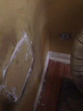

    On the inside a cut a strip of plywood and put that in the wall and then took the larger DT wallboard cut out and cut it smaller to screw into the round 3" venting hole. That worked out great since the wallboard is already painted the same color! Although I did have to add some spackle around the edge. There is some paint in the basement that is the same color for touch up. I did the same thing for the 2" OAK hole. That is even harder to do since getting my fingers in there is not as easy!

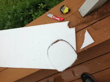

    Did some more hole plugging today! ! !
    If there was wood siding it may be easier to patch some in.
    The inside wall came out really nice, it just needs some paint. My friend has some in the basement that is the same color. The 3" vent was plugged nicely by cutting the larger sheetrock down from the Selkirk DT hole. A scrap piece of sheet rock was used to cut the 2" round hole for the old COLD OAK air! This will paint up nice after a little sanding. :)
    The outside is now all set for the vinyl siding. I glued a sheet of rigid foam in with RTV or liquid nails. There is extra siding in the basement they will finish it.
    YouTube has a very nice video FYI on how to slip a piece of vinyl over as a great temporary fix using a utility knife and a pop rivet gun!
    Another solution is to cut a piece of aluminum flashing and just screw it right in there. Nothing wrong with that, just a matter of how it looks. The aluminum flashing could then be painted the same color as the vinyl siding. A nice piece of Cedar Wood could also be painted and stuck in there too.
    Then it is all done!
