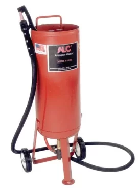

Anyone try this to to clean their pellet stove before painting?
Don2222
Feb 1, 2010
9,332
Salem NH
Hello
Has anyone tried this on a rusty pellet stove? Looks like it will do the job if you have a good hearty air supply.
http://www.northerntool.com/shop/tools/product_7960_7960
Also wondering about the mess it makes. Maybe doing it outside would work best?
I would assume the fire door must be pulled off, so the pyroceram glass does not get destroyed.
It seems like it sure would get those fire pots looking brand new!
Holds approx. 90lbs. of abrasives
Blasting Time: 30-45 Minutes
Welded Steel Frame
Pull up closure for loading of abrasive
Handle for moving ease
Durable tires
Large footprint for stability
Three sealing blocks
Pressure relief valve, a pressure relieving ball valve to meet OSHA requirements
Includes: Blast hood
Some assembly required

you'll need a very large compressor . think 80 gal , 5 hp min . and yes as to outdoors . the dust is unbelievable . also make sure you wear a respirator . silica dust is very bad for you :)
i sandblasted the frame and other steel parts of the '67 Triumph in my avatar in my driveway . was worth it but made a very big mess .
Just think of the compressor needed to do 80 cfm
You can get smaller sand blaster that use less air.
Use it outside and wear a mask or respirator the sand is
not good for you .
A small blasting cabinet would work good for burn pots, etc. I have one I use for car parts and other small items. Works well, and free was the right price.

They make them to use baking soda too.
Yes, I checked into the Soda blasters and they are good for removing paint, but not as good for rust.
You probably can run that with a 3HP compressor with a 30 gal tank, that is a a pressure blaster and will take far less air that a siphon type. there are sandblasting hood that are good to use they keep the sand out of your eyes. you can reuse your media if you have a way to capture it maybe build a large blasting box that you can sit the stove it. If you have any small casting foundries close they could provide you with dry sand at an affordable price, been many years since i bought any but it was 15 dollars for a 55 gallon barrel.
I have a small hand gravity blaster from HF that works well on smaller projects. Use before painting and welding.
overkill, i use a wire wheel in an air drill 90% of the time. if its really bag i use a "needle gun" which is like an air hammer with "fingers" normally its used to remove welding slag. works like a champ, portable, ain't that expensive and you don't need a big compressor to drive it
I sandblasted my 14 year old P61 and repainted it this year......its nice, but man, you use a lot of paint......4 cans!
