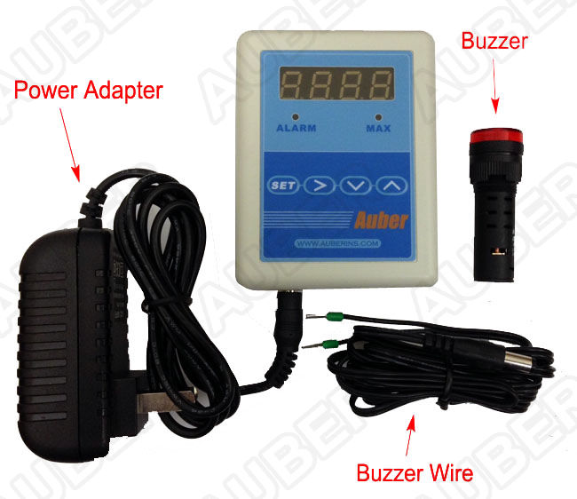

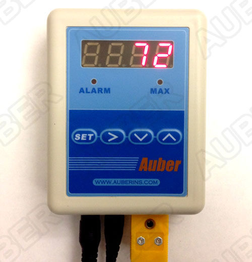

    Hi all, been reading for a while and decided to join.
    I was going through threads relating to thermometers and found this setup and thought I would post it. It is made specifically for monitoring chimney stove pipe temps. It was only added to their catalog a month ago so I figured a lot of you probably hadn't seen it yet.
    I am building a new house and have a hitzer wood furnace installed and was looking for a way to moniter my flue temp from the main floor and get alerted in case of overfire.
    I came across this and plan on buying it. Only thing I don't like is that I would like to hard wire it in to my wiring and I'm not sure how I'm going to do that yet.
    http://www.auberins.com/index.php?main_page=product_info&cPath=17&products_id=292

    Best you can do is put a receptacle near the device and plug the AC adapter into it. That way you can unplug it in the spring so it is not being a parasite on your A/C power.

    It looks one the the thermocouples could be bolted to something.

    I think the one with the eyelet is for surface mount. The other is obviously a probe.

    I haven't used one but it looks like a nice compact package. We get a lot of folks asking about this, particularly those that have basement installations. This could be a big help in monitoring a remote stove. They say that the buzzer cord is 3' long, but it can can be extended so that it passes through to the floor above. That's a nice plus. This device also could be useful for insert owners that have no place to attach a thermometer. The user interface is a little geeky, but passable. If you get one please let us know how it works out for you.

    I'm using a version of this device. A few months ago I ordered a thermometer with internal alarm from auber. I was using with a thermocouple attached to the woodstove surface with a high temp magnet(saw the idea on hearth.com). The digital readout of the thermometer was extemely helpful to determine stove performance from a distance of 10-15 feet. I had the alarm set around 700 degrees. High enough that it didn't go off daily but would alert me of a potiental overfire condition. My problem was that the internal alarm was not loud enough to be heard from the woodstove location in basement to the second floor bedrooms.
    So auber offered the solution of a external alarm buzzer that is extendable up to 120 feet. They upgraded my device for a small fee and now offer it specifically for woodstoves/chimneys.
    Pros:
    Device is laboratory accurate. Makes mechanical temp guage look like a toy
    High quality device. Has not skipped a beat in months
    Digital readout can be seen from 10-15 feet like on couch or just walking by.
    Alarm buzzer can be remote mounted 120 feet away. In bedroom or living room etc
    Simple to set up and operate.
    Draws only a couple watts.
    Cons
    Have to get creative to measure stovetop temp without drilling.
    Dependent on AC power
    I'm sleeping much better knowing this device is keeping watch on the temps.
    Btw I have no connection to auber.

    It's an AC wallwart converting to DC (likely 12v). Simple solution is a 12v battery. If you're worried about power outages and still having the alarm, use the wallwart (or an appropriate float charger) to trickle charge a small sealed 12v battery (lawn mower). Pull power from the battery for the alarm.
