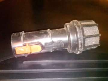

  19. Don2222
    Don2222
    Feb 1, 2010
    7,907
    474
    Salem NH
    Hello
    You can get a fancy and more expensive ash vac, but a shop vac with a good filter and this exhaust screen on the exhaust port will do the trick See pic below.
    Make sure the shop vac has the same diameter connection. They can be purchased at Home Depot.
    click pic to enlarge.

  20. DexterDay
    DexterDay
    Guest 2.
    I use a Shop Vac all the time (upstairs and down) and no compliants from my Wife....
    If you use the standard filter, you will create a dust/ash storm. You must use a HEPA filter (replaces factory piece of crap) and if you want to go the extra mile, buy some Fine Filtration Dry-wall Bags, that go inside.
    If there is no fear of Ember suction, then the Shop vac can have several uses (Car, Boat, Etc) where the Ash Vac isnt a good car cleaner (short hose and less suction).
    I sound like a broken record here, but as Don said above (another pellet burner) Shop Vacs are just fine... There are many more pellet burners using Shop Vacs, than Ash vacs. Many more. They just need the proper filter. Thats all that the ash vac has, is a bag filter (Dry wall bag) and the factory filter is HEPA on an Ash Vac.

  21. firecracker_77
    firecracker_77
    Dec 16, 2010
    1,438
    315
    NWI office - 2 Heritages; Chicago home - Woodstock
    Well that would certainly be much cheaper. Small shop vacs cost very little.
