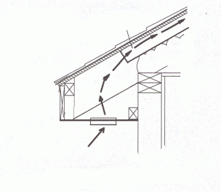

    are you sure the gap you are seeing is over the ceiling and not over the eaves ?
    [IMG]
    there shouldn't be insulation in that red area (if pic loads) and there should be some sort of through the soffit venting there (although my house has the insulation in the eaves, and no air vents)

    You need air in there. Get some soffit vents and then get those channel things to keep the air uncovered on the attic side. With the airflow protected on the attic side you could then blow in insulation overtop existing.

    Ja, both are important, the soffit vents and the chutes.

    You will need the soffit vents ,plus some proper vents to get the require air flow. Make shure any insulation is placed over the top plate. The proper vents will stop the insulation from contacting the roof. Dont blow cellulose over fiberglass, it should go in first, it gets in the nooks and crannies better. If you do use the fiberglass over the cellulose make shure you rip the paper of the batts.
