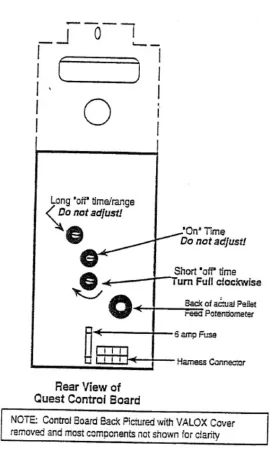

    The feed timing can be adjusted on the trimpots shown on this illustration taken from the service manual.
    I have also sent the entire service manual to you in a PM ( the conversation option on this site ).

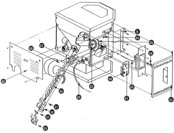

    Also below is a drawing of the involved parts.
    Good luck and keep us posted
