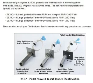

It seems as if my igniter chit the bed on my Astoria Bay pellet stove fireplace insert. It's 3 years old and I use a remote thermostat, so I'm assuming it has simply worn out. Naturally, I'm going to test it to be certain before I dive in to replacing it, but I wanted to know how difficult it is to access the igniter?? What pieces have to be removed to gain access?? Thanks for your help in advance!!
Hello
It should not be difficult. There should be one screw holding it in from the back. See pic (Hope this Helps)
The old 250 watt Travis Igniters were changed for large steel stoves to newer lower 200 watt igniters the end of september 2009
