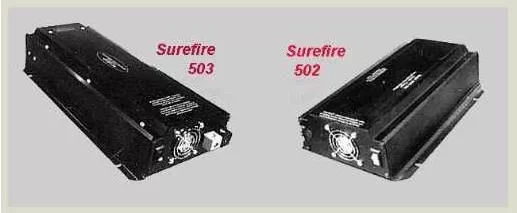

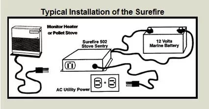

This surefire is made for a pellet stove battery backup and will give up to 13 hours.
http://www.medfordfuel.com/Surefire_Stove_Sentry.htm
The Surefire Stove Sentry is designed to backup or replace utility power. When it it used with a common 90 Amp hour RV battery, it's highly efficient circuitry provides approximately 8 hours of operation from a pellet stove or 4 hours from a kerosene heater in the absence of electricity.
When electricity is present the Surefire Stove Sentry charges a battery or bank of batteries and monitors electricity levels to your stove or heater. At the instant that a power failure occurs, the Surefire Stove Sentry converts the energy stored in the battery to AC power, assurring operation of the pellet stove or kerosene heater without interruption during the absence of electricity. Additional batteries can be added to the system to increase the available power backup available.
When commercial power is restored, the Surefire Stove Sentry reinstates commercial power as the primary electrical source to operate the pellet stove or kerosene heater. The Surefire Stove Sentry automatically commences recharging the battery, to return it to full capacity for the next power failure.

Don2222 has the right idea but the parts can be bought seperately and hundreds saved,but some electrical plumbing with proper cables and clamps is necessary. Heavy amperage in play needs proper safety. All the parts can be stored in a heavy tote case.

The harmans do not require a pure sine wave. All the harman dealers are trying to push their SureFire battery backups which are modified sine wave units. All they actually are are over-priced inverter-chargers. Look into some solar-power websites and off-grid inverter/chargers, they can be had for $2-300. You can expect about 8 hours of stove time off of a single deep-cycle battery and most of these units can handle the charging of 3 or 4 wired in parallel.

That is an interesting observation that Harmon sells modified sine wave backups for their stoves. Didn't know that bit of good news.
Went to SureFire's web site for the SF512 to check it out and you are right; modified sine wave output.
http://www.secamerica.com/modelSF512.html
