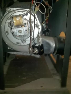

    My ongoing battle with the Big E that has no heat output continues. I added a potentiometer to the combustion blower. I let the unit get up to tempo on level #2 and was getting approx 100 degrees output air from the center top heat exchanger. I started backing down the voltage and I am at approx 20% right now and I have raised the output air temp by 28 degrees. My multi meter is in the van so I do not know the voltage but I will follow up on this.
    Remember kids, do not try this at home.
    Eric

    Bear what do I know about these things, Just a tinkerer here. I aint no certified tech or anything. So my stuff gets overlooked. Maybe I should have told him to replace the damper plate with the hole in it for one with a much smaller hole or no hole at all. Then you can pitch the rheastat!

    Curious to what you have for voltage? I think I got around 90 volts for a good burn on 3 with much more heat.

    90v, that low?
    I will grab the meter out of the van and try to play with that on Sunday when I come in to do some paperwork.
    Eric
  10. jtakeman Minister of Fire
    joined: Dec 30, 2008
    12,722 posts
    Northwestern CT.
    Depends on damper setting and what size hole is in it.
    It started at 116 volts(house current) for the one I tinkered with. 90 volts with the damper that has a fairly large hole(forget the size) and out about an inch on 3 setting. Fabbed up a damper with no hole and I could use full voltage on 3 with damper out 3/4 of an inch. Still had to reduce it to 110 on 2 and 100 on 1.
    This stove would run much better IMHO with a variable speed blower and no more fusing with the dang damper! One of these days will mess with a controller from another stove brand! One that can be reprogrammed. Still waiting for the warrenty to expire!

    I didn't like the way my Big E was burning. If I opened up the air control enough for a good vigorous burn, I'd have half burned pellets pop-corning out of the burn pot. If I shut the air down enough to keep the pellets in, I got a slow lazy flame, and not enough heat. There was no happy medium.
    I've never been very good at listening, so I put a rheostat on the exhaust fan, and after some fine tuning it's a new stove. I get a nice efficient burn, the ash has gone from black to salt and pepper grey. The output temperature has jumped 40 degrees, Going from 180 to 220. My house is 2 degrees warmer using 20% less fuel per day. All with similar weather and temperatures outside. I feel like the factory exhaust fan setting is just blowing all the heat outside.

    We played around and found that the Napoleon stove controller was a very nice fit for the bigE. We tried an Enviro universal, But the burnpot would over fill on the higher feed rates unless you used the mini setting. Mini setting didn't provide enough ump IMHO.
    You can also set and forget the damper with the napoleon controller. Only issue we saw is it still over fires(over heats) on level 5 heat range just as the original controller did. We we looking into upping the convection blower CFM to 200/250. But the owner found a deal on another stove. Stove was returned to stock before trade in and he sold the controllers he had purchased on ebay.

    I do use hi/lo mode, and I've tuned the blower and damper for level 3. When it drops to level 1, it's good enough. When it drops to single digits or lower, I'll tune it to run best on 4, and set the convection blower to high.
