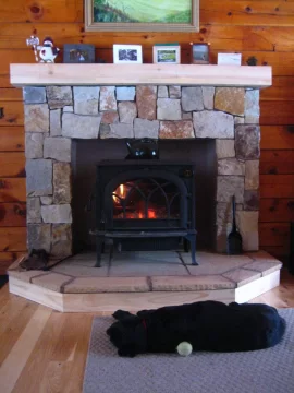

    My Lab fell in an icy creek behind our house. Once we got back inside, she chose this spot and hasn't moved for about a half an hour. One more advantage to having a woodstove. Just thought this was cute and wanted to share. IMG_4129.JPG

    you make the mantel shelf yourself?

    Yes, I did make the mantel myself. It is a simple box made out of 5/4 rough cut pine, which I beat up a little with a chain to make look more rustic. I made the box to fit tight over a 2x4 cleat that is bolted to the log wall. It just slips on tightly and put a couple screws into the cleat through the top of the boxed mantle.
    I made it in the summer and planned on only having it on in the off season, as it is a couple of inches too close to the stove for combustible material. I ordered a fire rated faux mantel, but it looked too fake and plastic. I have been watching the wood mantel like a hawk, but it never really even gets warm. So, I am no longer worried about it.

    Very nice install. I have an insert but sure do like the looks of a freestanding unit on a hearth.

    Sharp looking install.

    Great looking install!

    very, very nice! Love the mixture of stone and wood.

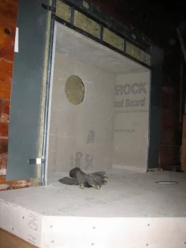

    Nice looking install! The picture is a little hard to make out behind the stove but what the black surface behind the stove?

    Thanks for the nice comments everybody. It was pretty hard work, but fun at the same time. Behind the stove is a box that I built out of steel studs and older generation 5/8 inch Durock. I then skimmed coated it with the same brown tinted mortar that I used on the stone surround. The box is where a prefab, junky, ZC fireplace used to be when we first bought the house. IMG_2628.JPG IMG_2778.JPG

    OH WOW, What a difference. Great job! That tears it, I'm coming up there to jump in the creek.
