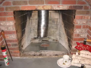

Here are some pics of where I'm at with my install. Lets hope Hampton delivers tomorrow like they promised. I've been waiting for 4 months.

Again, great feedbacks and photos.
Bills330i, Looks like your ready to go. I see the Merry Christmas sign to the right, With an EPA II stove and double walled SS sleeve, st nick better take the window or door!!!
I told the kids we will leave the door unlocked. They wanted to know how Santa was going to fit down the 6" liner.
