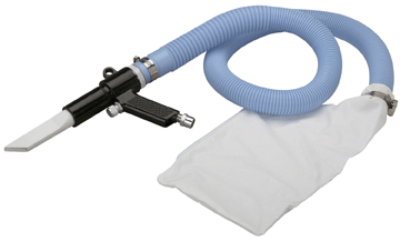

    Has anybody tried this gizmo (Harbor Freight vacuum gun, $10)? My buddy picked on up for me and I used it tonight. I was impressed with it. I used it to remove ash and clean the tubes.
    The gun has a 1" suction port that I extended with a 36" long piece of 3/4" PVC pipe. Compressed air is used to create the vacuum and the output side goes through a flexible hose into a collection bag. I think I will make a 5 gallon bucket to replace the bag. I have used a shop type vacuum in the past but the filter will plug with fine particles and loose power or stuff get stuck in the hose. This machine is just a straight shot no filter to plug or places to jam up.
    Pull the trigger and the gun sucks up the ash. I slid the PVC pipe down the tubes and in areas around the refractory, rather nice way to clean without the need to climb into the boiler. I can clean the tubes in 2-3 minutes. I suppose a water filter could be rigged up by leaving the lid on the bucket and exhausting into the water, then the water could be dumped out. I will give that a try.

    Interesting idea, Steve.
    This past fall, I rigged up a FrankenVacuum using an old vacuum cleaner with one of these mini cyclone separators [below] in front of it to catch most of the ash so that the bag would not fill as quickly.
    http://store.oneida-air.com/dustdeputysystems.aspx
    It did make a big difference; perhaps a combination of the concepts (I'd tend to think that a water bucket would create too much back pressure)

    Interesting concept, but I don't know how much I really like it... I suspect that it probably isn't very good on efficiency - how much energy does it take to compress the air that it uses, and how much of a compressor does it take? What does it do with the air that it uses to suck with? I don't see how that bag can cope with the dust once it starts to build up - certainly I'd expect to see it moving more air volume in total than a shop vac - it would be using both the air that it sucked and the air used to generate the suction, while a shop vac would just be moving the air it sucked with...
    The other big concern is the same as with any non-fireproof vacuum, namely the need to be very careful not to suck up any live coals or other flammable material...

    It will be interest to see how the water trap idea works. A few minutes of run time is not much energy. I think it uses 5 cfm, just about any compressor should work, it only takes about 3 seconds of triggered run time to clean a tube.
    The compressed air goes to the waste side, creating a vacuum which has a straight unimpeded shot through the gun to the waste side. I tried just pointing the waste side outside th shed and the ash is shot out 20 feet.
    The bag is definitely not the way to go, I think exhausting through water will keep the return air clean and capture the fine particles. Any dry vacuum has a limit to the percent it can clean the exhaust air.

    I bought one of those vacs years ago when I used to do auto body repair. It's really handy if you already have compressed air around for other things. It doesn't work as well as a good shop vac, but it does a fair job given it's size and cost. I ditched the bag and wired up the hose to mount into a 55 gal trash can. It beat using a shop vac as it was easier to get to the job and you don't have to empty the vac when you're done. I'll have to remember to pull it out of the tool box when I clean out the Tarm this spring, I don't think it's been used in 10 years.
