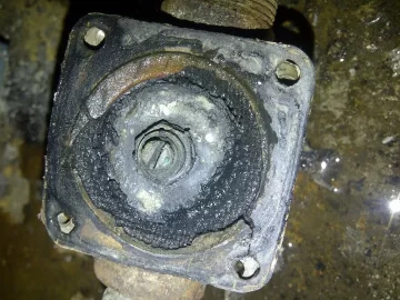

    So i just changed the expantion tank and the pressure reducing valve, after filling the system the pressure is about 16psi i just lit the wood boiler so i guess ill see in about an hour or so iff it worked, also i dont have an LWCO there is a valve before the pressure reducer should that be closed after its filled.
    This is the old valve
