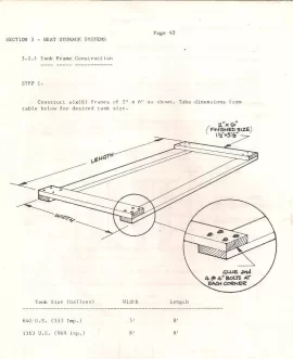

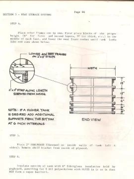

    These instructions come from our 1981 Jetstream Manual. Tom in Maine has recommended that you should use pressure treated wood and stainless steel fasteners to build these tanks.
