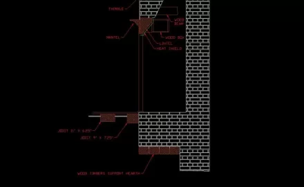

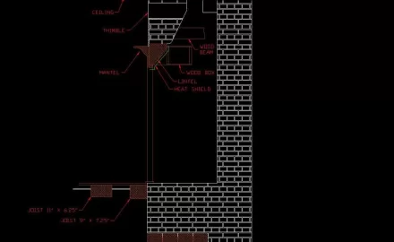

The joists below are large timbers, but unfortunately fatter than they are tall. They run parallel to the front of the fireplace, the one directly under the front edge of the hearth being 9" W x 7-1/4" H, and the next one out from the fireplace being 11" W x 6-1/4" H, as shown:

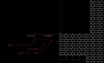

Obviously, I do not want to recess the hearth extension into them, reducing their effective height even further. However, I could rabbet into one edge of each to set a plywood subfloor panel, as shown:

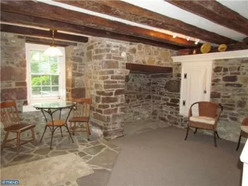

They can be seen in this photo of the basement area, directly below that fireplace, as a lintel above what appears to be another fireplace in the basement.
