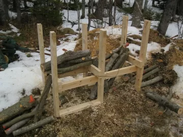

    I should have done this a couple years ago..
    I know.. pics or it didn't happen. I was too excited to try it out.
    Simple 3 H design. 5 2x4s from lowes.
    20 minutes.. and it holds ALL the little stuff. I'm gonna put a driveway marker for length out the front.. then I get 3 cuts of 2 foot length.
    No little stuff zipping around, or trying to step on it.
    Best 15 bucks I've spent on wood cutting stuff.

    Well I for one am confused. Pic?

    I tried to find the thread where I got the idea. I'll get a pic tomorrow.

    As promised. I added in a fiberglass driveway marker on front, so I can get an accurate 24" hanging off the front for the first cut. IMG_0703.JPG

    Oh, a sawbuck -- now I get it. Thanks!
