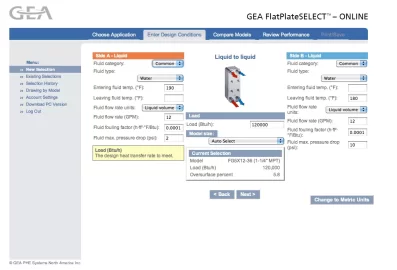

    You can go to www.flatplate.com and use a free HX sizer.
    If you have 180F on at A side of the HX you should be able to get to 170- 175F on the tank side. You need enough boiler output to cover any load while you are trying to charge the tank. On a low, or no load day, all the boiler output will be able to go to charging the tank.
    The closer you want the tank temperature to the boiler temperature, called close approach, or the faster you want to exchange, the larger the heat exchanger required. And you need enough pump capacity to move the GPM through the HX.

    The other one is probably related to heat exchanger sizing. When I size a plate HX in the situation you find yourself in, I pretty much ignore the btu ratings on the hx. Usually they are based on a 20* split from side A to side B and your system, or any other like it demands what is called a close "approach temperature". A close approach is a function of nothing more than the amount of transfer area in the HX and flow rate. You want to get Side B as close to side A as possible to effect maximum heat going to your storage.. You will find that generally speaking you may need to upsize the hx by 50% to get the temps tight. Without getting into all the math (which you can easily do on Flat Plates website) I find that in a situation where a 40 plate might do the trick for straight btu transfer, a 60 plate may be needed to get the temps really tight.
    I'd look at that first and see how close your two sides are running. You want to get them within a degree or two with enough flow to stay ahead of the actual demand going to your heating load. If the boiler doesn't have enough grunt to keep up that will become apparent very quickly once you get the HX where it needs to be.

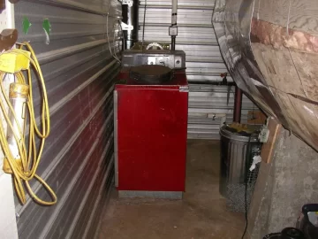

  10. With the Jetstream boiler I had a very similar problem.
    The 1000 gal storage tank and the boiler were to share the same water with a vented expansion tank a floor above giving 3 psi at the boiler. Kerr, the maker of the boiler, felt there would be a corrosion problem at this low pressure. Recommended using a coil of 120' of 1" copper in the bottom of the storage tank for a heat exchanger. This arrangement did not work as I could not get the storage above 170 degrees. The heat exchange was just not fast enough. Your Elite and the Jetstream are similar in output at 120,000 BTUs per hour. The water between boiler and storage now circulate directly, using a pump moving 35 gpm and now I have no problem getting storage to 195 F.
    Heaterman's and In hot Water advice, I believe, are in the right direction for boiler.
  11. The system that I have with a vented expansion tank a floor above the storage and boiler; it is not really pressurized but still runs at 3 psi at the boiler. Should it be called an open or closed system?

  17. The storage tank is an ex-Steam Boiler with its flame tubes removed. 56" diameter and 106" long. The heat exchanger was a flat grid made of 1" rigid copper running the full length of the tank at 8" from the bottom of the tank. The spacing between each pipe section was whatever 180 degree 1" copper elbow would give and all the pipes were at the same level. With the boiler aquastat set to shut the blower off at 190 degrees, I was unable to get the tank over 170 without cycling.
    The previous boiler had heated the tank as a gravity system and had no problem getting storage to 195, so I went back to circulating the water between the boiler and tank directly. If the storage and boiler water were pressurized, I could likely use a much smaller circulator.
    If solar ever becomes a useful alternative, I have a ready and waiting heat exchanger in the bottom of the tank.
