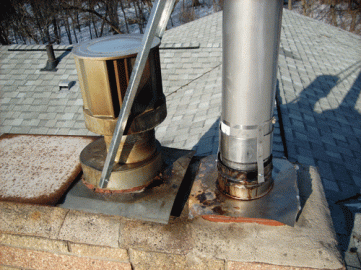

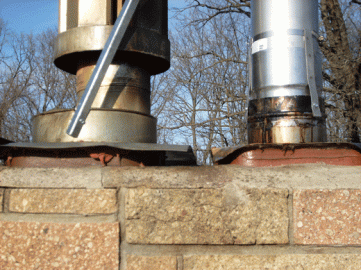

Now I see the third flue someone mentioned. It is loosely covered with a metal plate. That could certainly be a problem, right? They've been on my roof 4 times now and knew about the problem and no one mentioned that.
Is there something I can do myself with that?
No one has said if I have any rights about telling them to take it out.
If that plate is just loosely sitting up there. Get yourself some silicone, lift the plate off, clean the underside of the plate & the top edge of the tile its covering real good. put a nice 1/2" or so continuous bead of silicone around the top of the tile top edge, and set the plate back on.

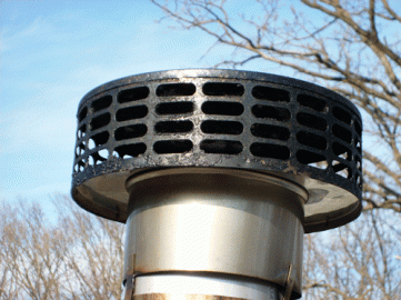

Another problem I see, is the stack to the right in the photos, has no storm collar around it, and rain water can easily run inside along the pipe there.
Not sure what the straps are for from the old pipe to the new, but that looks kind of rigged to me.
One other thing I noticed:
The braces coming from the new extension of pipe, has one of the braces secured & screwed into the top plate of the stack next to it. Not the best set up I seen.
What is to keep it from pulling that top cap off in a high wind event? Your installer needs a kick in the ass.

From the photo it looks to be flat on the flue and it must be heavy enough not to fly off. I doubt that it would cause your problems. And yes we (I) am frustrated because it is a serious problem yet it's not rocket science. I'm hopeful the chimney extension will solve the case and you and your hubby can enjoy the wood burning experience. Just do one thing at a time till you are successful. Be safe

The owner doesn't do any of this......he sends guys out. My husband about had a heart attack when he saw how they rigged it up there. I have never seen anyone with that sort of a rig on the top of a house.
I'll get up there and get that sealed up.
