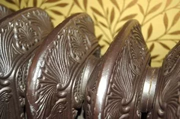

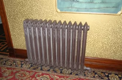

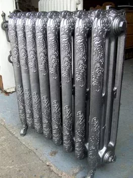

  23. kenny chaos Minister of Fire
    joined: Apr 10, 2008
    1,995 posts
    Rochester,ny

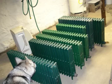

  24. 88rxn/a New Member
    joined: Feb 12, 2008
    145 posts
    northeast PA
    WOW! thats really nice!
    i wish mine had the detail like that!!
    as you can see, GANDER was just as excited as i was getting these...
  25. Eric Johnson Minister of Fire
    joined: Nov 18, 2005
    5,703 posts
    Central NYS
    Very nice radiators.
    I was at the Jerome Hotel in Aspen CO a few years ago and saw these beauties. They were stripped and clear coated; they look a lot like Kenny's.
