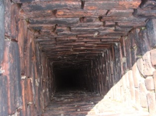

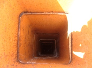

    There is nothing wrong with a masonry chimney so long as it is sound and there are no cracks.
    When you say brick all the way to the top, are you talking about the outside and inside of the chimney? Or is there a terracotta liner that runs up the inside of the chimney? If it is a very old chimney with no terracotta liner on the inside (the bricks are visible to the sky) then I'd have reservations using the chimney. If there are terracotta liners in it, and they are in good shape (no cracks, chunks missing, etc) then I'd be fine running the unit if it was cleaned regularly.
    Even if money is tight, that chimney brush is something that you really need to have, and luckily, they come cheap. If you don't want to buy the rods for cleaning, you can use rope and do just fine.

    Good: [IMG]
    Not Good: [IMG]
