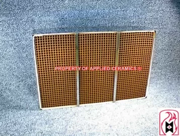

  10. southland New Member
    joined: Oct 28, 2008
    87 posts
    Alabama
    Attached is an image of the cat from Applied Ceramics web site. While it's one unit, it does have three cells, probably for ease of manufacturing.
    Since the model 91 can be used as an insert, removal of the cat from inside the firebox is probably the best design.

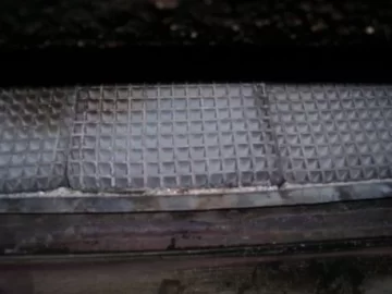

  11. North of 60 Minister of Fire
    joined: Jul 27, 2007
    2,449 posts
    Yukon Canada
    3yr old cat burning 8 to 10 months a year. Pine, spruce and poplar is its only food. It gets a paint brush and vacuum run across it twice a year after lifting out the stainless flame shield that takes 10 seconds. It also has three sections but it is actually one piece.
