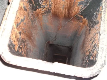

    Here is another pic of the chimney better showing the crack in question.

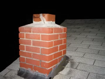

    Here is a picture of the part of the chimney seen above the roof. This chimney is on the outside of the house. Also you can see where the previous owner has attempted to "repair" one of the cracks.

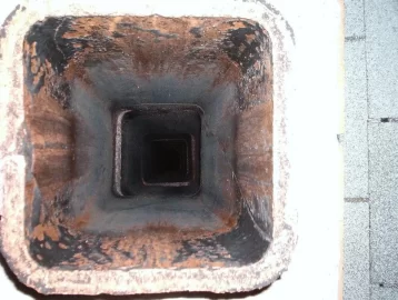

    Here is the last picture that I took. This picture is from the cleanout and up. In the second tile up and on the left, you will see another hair line crack.

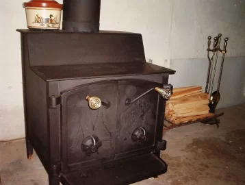

    What the heck, as long as I am taking up site space with pictures, I might as well do it well! I'll show you what utilizes that chimney
    (Hope that is OK, please let me know if it is not kosher)
    here is a pic of the old Grandma Bear. It may be old but it certainly did a nice job last winter here in the Endless Mountain section of Pennsylvania.

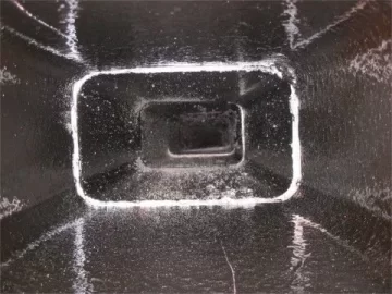

    Holy 3rd stage creosote batman! I have seen that pic on the web not associated with this site before. Always interesting to put info on the web together with its owner. There must be an impressive cleaning story to go along with that! I couldn't imagine what it would take to remove that with a brush, if it is even possible.

    It was a really thin glaze. Burned off fast with no drama.
