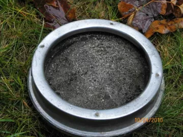

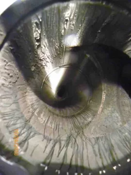

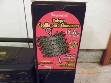

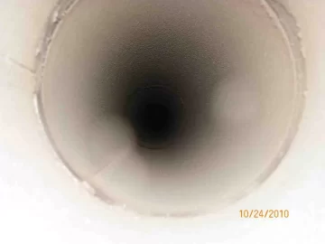

Mr.Kelly what size is the flue and your brush? I use a spray called Anti Creo-Soot which will change any buildup to light fluffy ash, attached are some pictures of my last cleaning.
zap
The first picture is the cap off the cleanout,1723 is the pipe before the cleaning and 1733 after the cleaning. I clean from the bottom up.
