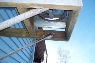

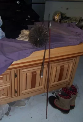

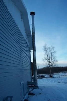

Good day to check the flue. Good fire burning. I was surprised I could see al the way thru with a fire going.
I pulled the clean out plug & had about 1/2" of gray & black dust.
Snapped some pics up, looks good to me.
I can see some creo on the top-cap but it's nothing bad by any means. I think that's to be expected as it is
the coldest & any creo would form on it if I was having any creo issues.
Was brushed in Oct. A little over 3 months of 24/7 fires.
For what you can see, does it look OK?
