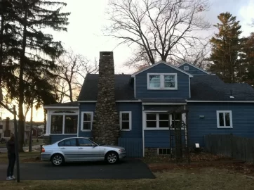

    Just wondering if you guys have any thoughts on a quote of $3800 for a chimney rebuild. It is roughly 9 feet or so above the ridge line which is where they are going to start taking it down and rebuilding it using the existing stone. I wonder how tall I could have him build it. IMG_0544.JPG

    $3,800 seems a bit high - around here masons get $90 per hour. Could be more work to rebuild with the same stone as it will be like putting together a puzzle. Will they be taking out the permit or are they asking you to do the permit? Do they carry their own worker's comp insurance? If a sole proprietor, they do not need workers comp in this state. If he has a helper - that changes things. Check those things out and also check with your house insurance if he is unlicensed to see if they would cover an injury. Hate to be a Debbie downer, roof work is dangerous, you want to make sure they are legit.

    Get a few quotes from certified masons and be sure to ask for some recent references that you can follow up on.
    PS: How bad off is the chimney? From a distance it looks ok.

    1. What is the structure? Stone veneer on concrete block? Entirely stone? Any vertical rebar or other reinforcing?
    2. Why is it being rebuilt? Structure unsound and needs entire replacement? Or just veneer being taken down?
    3. Height...should be at least 2' higher at top of flue than anything within 10' horizontally from that point (the gable roof to the right). Looks like it is currently OK height code wise. May want to add height for better draft, but that does raise questions about keeping it structurally sound.
    4. Make sure there is a proper cricket installed on uproof side of the chimney. It can be challenging to properly flash the roof to rounded stones.
    5. You might want to add some kickout flashing or a gutter so roof runoff isn't splashing onto the flared out chimney base below roof edge.
    6. Consider demo'ing the entire thing and substituting a class A chimney through the roof. While it does add architectural character, the stone chimney is a big hole in your building's thermal envelope and can be a maintenance item long term, between mortar repairs and water infiltration.
    7. Is line with clay flue tile and are repairs to same needed below the roof line?

    It's pretty bad I was up a couple of weekend removing the concrete cap on the top. While doing this I felt the whole chimney move. I've only brought in masons who were recommended on Angie's List. Out of the three I really only liked one however he was pretty expensive.

    1) It's all stone all the way up. From what I can tell there is no rebar or other reinforcing.
    2) It's being rebuilt because it's unsound. I was able to feel it move when up there with a ladder a few weekends ago.
    3) The current height does meet the 2' 10' rule. His quote was to take down and rebuild with existing stone to existing dimensions. In my response to his quote was a question of how high can we go and how expensive is that.
    4) His quote said that he would use copper flashing.
    5) Since taking that picture I have installed gutters on both sides to prevent runoff on the flared out chimney base.
    6) How expensive is class A chimney? I really like the character of the chimney and my wife LOVES the character of the chimney. I don't think I could convince her of running class A all the way up but if it's significantly cheaper then it maybe I would reconsider. It's about a 16' run from where the stove's rear exhaust is going to sit.
    7) It is lined with terracotta tile and I don't think any repairs are needed below the roof line. Maybe some minor repointing but as a whole it looks pretty good.

    looks like you have what we call field stone - not sure there are many masons around that do this kind of work, especially in eastern mass. You may find someone in western mass in the hilltowns.

    Actually I would bet you can find a lot of masons in eastern MA who know how to deal with it. Lot of antique houses around, and lots of folks who work on them. There is an outfit right in my town called masonry restoration that does this kind of work on all the 18th and 19th century homes in town.
    I'll cast another vote to keep the stone and maintain the character of the house.
