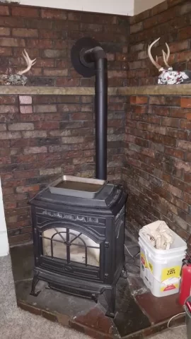

Hopefully this picture will show up. This is what it looks like.

Like said above, never seen anything that could catch fire like in a fireplace or wood stove flue. Looking at your pic, I'd say you are gonna find trash at the back of the stove before the up pipe when you do clean it out, so have stuff covered.

In your install and not knowing what goes on beyond that brick fascia that your venting enters into, you should find the majority of your ash build up right in those pipes you can see. The first ten feet or so of venting collect the most of it, with little pockets of it the rest of the way up . Hopefully there is a clean out tee at the back of the stove, that would make running a brush and flex rods up that portion of your vent much easier than disconnecting pipes. At this point in time we don't know if your chimney has a stainless liner in it or if it is masonry but either way that will need periodic cleaning as well.

What brand of pellets are those? If their ThermaGlo's (which are trash pellets and have a tan bag), I would say you need to clean that vent at least every ton (experience talking here). If they are really good pellets, you will probably be okay thru the winter. If they are middling pellets (FSU-type), then every couple of tons will probably be good.
Reactions: alternativeheat
I see in the photo a Tidy Cat container, can't make out what the pellets are. I burned some ThermaGlo recently, more ash than Maine Wood TSC pellets and not as hot.
