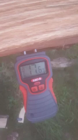

It will be built and sealed well. I have been speaking with the builder and told him my plans to do as much of the heating with a stove and I'm willing to pay extra to make sure its done correctly! You reassured me in my posts when I was contemplating the purchase! If the NG furnace has to run a bit it won't be the end of the world.If your wood is as dry as your meter says,
