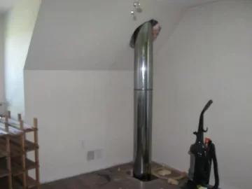

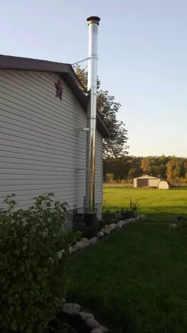

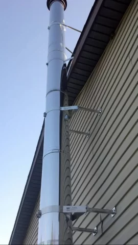

Ok I am about to install a chimney in my basement probably connected to a englander 30. Its coming out the wall and up on the long side of my house (where my gutter is, not the eave side). I'm thinking about going with a class a stainless triple wall chimney, it will be approx. 21'. My question is should I try to keep it as close to the house as I can (outside of the 2" min) so I do not have to run the flat pipe inside for such a long stretch? If so what do I do once I get the the overhang of the house, use a offset to get past it or cut into the house and fix the house around it. Or do i make the horizontal piece longer inside to keep it further away from the house all together? As you can tell this will be my first chimney ever built and your knowledge would be appreciated....
