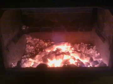

I like front center as well. Lights off better and more complete burn when going 24/7.
  • [Hearth.com] Coals Spread Out or Raked to the Front
I ppull them to the front to try to burn them up a little more completely.
Using kindling should not be required on reloads. I do not always slide the coals to the front and probably do that only at night. Other times I just level them out and put the wood in. The only difference it seems to make is that if I do slide them forward, that bottom piece in the rear tends to burn slower. Still, not a lot of difference in burn times unless one counts the lower firebox temperatures as burn time. For us, if the stove gets down to 300 degrees, we're usually looking to add wood and not let it get down further. In the coldest part of winter we don't even want it to get down to 300 degrees. Once again I state that we do not like the big temperature swings which are common with many folks. We like a more even temperature in the house and are able to achieve this very easy.
