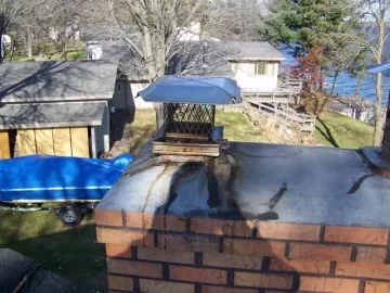

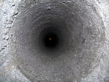

I went on the roof today to check things out since the install about a month ago and did not like what i saw. flaky creosote build-up on the outer part of the cap and it looks like it ran around the joint too. its flaky dry on the outside and smooth black, not sticky, on the inside of the cap. The inner wall of the stack is black but not flaky. very little soot. We have been burning fairly regularly, usually evening's into overnights. We have to leave the door cracked until the wood is well engulfed in flames or it will go out. Once the stove reaches 400-425 i start to close down the air, usually to 3/4 open, then 1/2, then 1/4. with about 10-15 mins in between each. stove will reach about 500-550 but only for a short time( less than an hour). I get secondary's for about 2hrs then its down to coals. total burn time on a full load about 3 1/2 hrs. wood is cherry that has been split and stacked since spring 2009. Moisture meter says 13-15% on every piece i check. I am checking the wood the right way by splitting the splits and checking the fresh side. glass stays clean. it passes the dollar bill test on the door, nice and tight. Not sure if i have a draft problem or an air issue. Stack is new and installed by the book and is the recommended height by the stove manufacturer. about two feet off the peak of the roof so it has clear surroundings. So stove gurus, Help a rookie out. What am I doing wrong?
